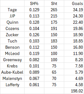

LGR4GM Posted August 22, 2024 Report Posted August 22, 2024 (edited) In 2023 the Sabres goal totals dropped. They had 293goals in 2022 and only 244goals in 2023 for a drop of 49g. Obviously as a result this team was worse. The question is do they have enough scoring to get back up closer to the 290 mark? And also how many goals do they need to just make the playoffs? Let's answer the 2nd question first, right around 270g is a solid number to make the playoffs. Last year 12 of the playoff teams had 270+/-5 or higher in goals with only 4 teams falling below that. For Buffalo then the goal should be 270g. Now the first question, do we have enough scoring for 290, no. Not unless you think the defense is going to put up about 100 goals. Right now I have the Sabres defense coming in around 40goals+/-5. The forwards clock in around 198goals+/-10. If you give everyone the benefit of the doubt and math it out we end up at 253goals as the max and 238 as the minimum. The only way to exceed that 253 top end is either A. to bring in more scoring (which is why everyone wants another 20-30g scorer) or B. up the number of shots the team takes, especially their top guys. I think asking Lindy to create a system with more shots is possible. I also think that Quinn and Benson are wild cards because there is not enough shots and goals for their career sh% number to have much stability. Is Quinn going to get 23g or can he exceed that? What about Benson only getting 17? Is it possible Buffalo can hit that 270 threshold with the current roster? Sure, we are 17 goals away at the top end. If players stay healthy and Ruff is good, we could do it. But players will get injured and frankly there is a lack of proven depth. Can we get to 270 with the current roster? Yes. There is a path there with some modest improvements to get the extra 20ish goals we need. I would feel a lot better about it though if we brought in 1 more top 6 forward. Last part: You may ask how I got these numbers? I took every players career sh% (some got a little bump due to their last few years being clear signs of improvement) and then roughed out their average shots. A few due to lack of data require some guesstimation work but in the end I will post what I got in the raw numbers for debate. I didn't used games played as I feel that shots and sh% are better. Players can miss games and make up for them with shots or a better shot percentage. I also think sh% and shots is more stable. Edited August 22, 2024 by LGR4GM Chart error 4 Quote

LGR4GM Posted August 22, 2024 Author Report Posted August 22, 2024 11 minutes ago, dudacek said: I'm curious to see what trends are historically when you compare career averages to averages over the first 200 or so games. I suspect guys like Cozens, Krebs, Benson, Peterka, Quinn, McLeod, Power, Byram and even Malenstyn are at a point in their careers where we should generally be expecting them to score over their career average. No you shouldn't to all the bolded. Most of those guys are either A. old or B. over 200 games already. 1 Quote

LGR4GM Posted August 22, 2024 Author Report Posted August 22, 2024 20 minutes ago, dudacek said: My point was that I suspect their average over their second 200 games to be higher than their first 200 games. Byram and Power have played about 160 games each, Malenstyn 100. Krebs and McLeod just over 200 I didn't average their first 200 games. Also, your theory is everyone gets better, they don't. 1 Quote

GASabresIUFAN Posted August 22, 2024 Report Posted August 22, 2024 Byram. 0.116. 75. 8.70 @LGR4GM These numbers seem low. Hockey-reference has his career shooting % at 11.9% He has also taken 219 shots on net for his career in 164 games. That’s about 110 shots per season. That actually projects to 13 goals next season. Considering he has 10 in 42 games 2 years ago and 11 in 53 games last season. We should expect a higher total than you projected over a full season. Quote
GASabresIUFAN Posted August 22, 2024 Report Posted August 22, 2024 2 hours ago, LGR4GM said: I took every players career sh% (some got a little bump due to their last few years being clear signs of improvement) What site did you use? Hockey-reference has Lafferty at 10.3%, Tuch at 11.4, Zucker at 12.2 etc.. Quote

LGR4GM Posted August 22, 2024 Author Report Posted August 22, 2024 (edited) 47 minutes ago, GASabresIUFAN said: What site did you use? Hockey-reference has Lafferty at 10.3%, Tuch at 11.4, Zucker at 12.2 etc.. I used the last 3 years average on hockey reference and I adjusted them as I saw fit. Edited August 22, 2024 by LGR4GM Quote
LGR4GM Posted August 22, 2024 Author Report Posted August 22, 2024 1 hour ago, dudacek said: Never said you did. My theory is most do, and I posed a question. Your theory is the same theory as Kevyn Adam's. That guys will internally improve, they could but you need a lot of ppl to improve while NO one gets worse. 20 goals have to come from somewhere. 1 hour ago, GASabresIUFAN said: Byram. 0.116. 75. 8.70 @LGR4GM These numbers seem low. Hockey-reference has his career shooting % at 11.9% He has also taken 219 shots on net for his career in 164 games. That’s about 110 shots per season. That actually projects to 13 goals next season. Considering he has 10 in 42 games 2 years ago and 11 in 53 games last season. We should expect a higher total than you projected over a full season. Byram could outproduce that. He hasn't to this point though. 1 Quote

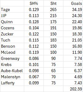

LGR4GM Posted August 22, 2024 Author Report Posted August 22, 2024 @GASabresIUFAN if I give Tuch a 11.5% and bump up Byram to 105 shots that gives us about 4-5 extra goals. Again, though that implies NO one else drops below their numbers. Just now, JoeSchmoe said: Imagine if we still had Skinner and Mittelstadt. We can do that, who are you taking out? Quote
LGR4GM Posted August 22, 2024 Author Report Posted August 22, 2024 (edited) Let's take out Lafferty and Kubel. Now the issue here would be opportunity for other players which might drop their shots down but that gives you about 30ish extra goals after you account for 10-12 of Byram's goals disappearing too. Gives us about 240goals at forward (again this is a rough estimate). Edited August 22, 2024 by LGR4GM Quote

LGR4GM Posted August 22, 2024 Author Report Posted August 22, 2024 @GASabresIUFAN I adjusted numbers based on your thoughts. Here are the updated totals. Quote

GASabresIUFAN Posted August 22, 2024 Report Posted August 22, 2024 (edited) 1 hour ago, LGR4GM said: if I give Tuch a 11.5% and bump up Byram to 105 shots that gives us about 4-5 extra goals. Again, though that implies NO one else drops below their numbers. I am also worried that some may slip, but considering how low in production that new bottom six was last year, i’m not looking for to much regression there or from JJP after his breakout year.. I also believe most of top guys lost production partially from the stagnant PP. Any uptick in the PP should help list most of the boats in the top 6 forwards. I have looked at how we get to 265-270 a few times this offseason. I wrote this yesterday in the big picture thread. Quote Here is an optimistic post about the possible upside for the offense. I wrote in my earlier post that the Sabres would need to score about 265-270 goals to reasonably expect to make the playoffs. When we scored 300+ a few years ago we had a poor defense and terrible goaltending. The defense is marginally better, but the goaltending should be a strength, so I’m going to assume we keep our GA to 250 or less. The projected 21 skater lineup scored 227 goals last season. The forwards scored 180 and our defenders chipped in another 47. So where should we look for another 40 goals? 1) Quinn - Quinn scored 9 goals in 27 games last season - If he stays healthy I think 27 goals is a fair but possibly low estimate (+18) 2) Benson - Assuming he plays on the 2nd line, his production should jump in year 2 from 11g 19a to reasonably 18g 25a. (+7). To show what’s possible, JJP went from 12g 20a in year 1 to 28g 22a in year 2. I don’t think Benson is a JJP level goal scorer, but he is probably a much better playmaker. 3) TNT - Tage has averaged 38 goals the last 3 seasons, last year he scored 29, but came on after being hurt early. I don’t expect him to shoot 15%+ like he did in 21/22 or 22/23, but a rebound to closer to that number seems reasonable, thus about 35 goals as a projection. (+6) 4) Cozens - He isn’t as good as his career year (31 goals), but he isn’t as bad as last season (18 goals) split the difference for 25 goals (+7) That’s 38 additional goals from 4 players. Any improvement from Tuch or JJP would add to that projection. I don’t expect much if any increase in production from the 3rd (34 goals - Zucker, McLeod, Greenway) or 4th (29 goals - Kubel, Krebs, Lafferty, Malenstyn) lines or really from the defense. I can see Dahlin slipping a little from 20, but possible increases from Power (6) and Byram (11) to offset any decrease from Dahlin. The rest of the defense is a goal scoring void. The biggest issue is health. Keeping the majority of our top 6 forward and top 3 D healthy this season will go along way toward getting to the playoffs. The drop off in talent from our top 6 forwards and top 3 defenders is huge. I also posted a similar analysis to yours in another @dudacek thread earlier this offseason. Ultimately, the road map to 265-270 is going fall on rebounds from Tage and Cozens, a healthy and productive Quinn and continued improvement from Benson. The key to a Tage rebound is the PP. His PP goals feel from 20 to 9 last season. As to the rest of the roster, I think we could see increase from Byram (who needs to play a full season) and Tuch, but also decreases from Zucker and McLeod who won’t be playing with Draistal this season. I’m not expecting anymore than 60 to 65 goals from our bottom 7 forwards. Edited August 22, 2024 by GASabresIUFAN Quote
