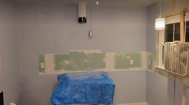

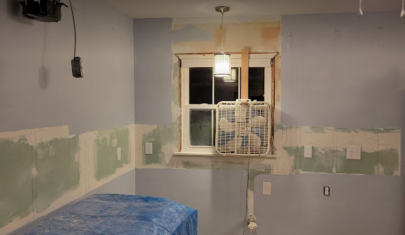

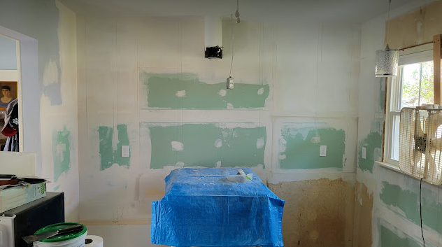

Doohicksie Posted March 17, 2023 Author Report Posted March 17, 2023 (edited) Well, the walls are closed up. Need to sand and paint and then onto the cabinets. Finally. Edited March 17, 2023 by Doohickie 2 Quote
Doohicksie Posted March 21, 2023 Author Report Posted March 21, 2023 I got a little further since I took those pictures, basically put up the mounting rails on the walls. I was going to start assembling cabinets yesterday but my wife is still looped from the combination of DST and her trip back east last week and went to bed at 8 pm. I might be able to get something put together today. I took the time yesterday to inventory and stage the IKEA boxes in order of assembly, and set up my work area (a door laid across two sawhorses). I also made a list of a few more items I need to get from IKEA. The kitchen sink we ordered from Lowe's was originally supposed to be here this week but it won't get here until April 21 at the earliest. I found an alternative, not exactly what I wanted style-wise but may be a better fit for the plumbing arrangement; I'll pick that up in the next few days. Quote

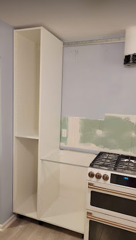

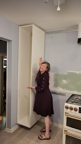

Doohicksie Posted March 22, 2023 Author Report Posted March 22, 2023 Mrs. Doohickie showing off her first new cabinet. This monster, just the empty shell, weighs over 100 pounds: I got a second one up as well. I think they will go faster as we go. The next two cabinets will require some modifications though, so those will take some time. 1 Quote

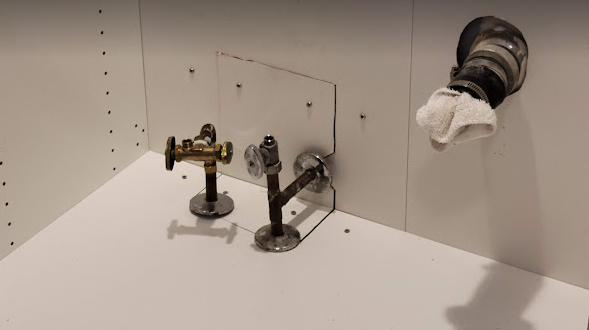

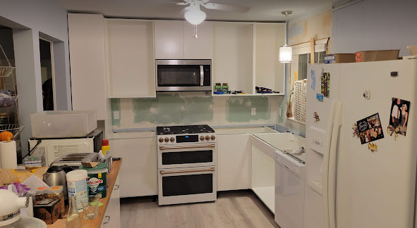

Doohicksie Posted March 27, 2023 Author Report Posted March 27, 2023 (edited) Progress. I got the sink cabinet with the tricky water feeds installed. Dishwasher is fully installed and will be functional as soon as I have a drain (...if I only had a drain!) Edited March 27, 2023 by Doohickie Quote

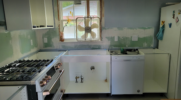

Doohicksie Posted March 27, 2023 Author Report Posted March 27, 2023 I got the corner cabinet and sink cabinet all figured out and joined together. The trim between them came out just the way I hoped and they're very solid now. Quote
Doohicksie Posted March 27, 2023 Author Report Posted March 27, 2023 The microwave is back in place and working. All of the base cabinet frames are in, most of the wall cabinet frames are in. I will probably get the rest the cabinets up and start putting in doors and drawers but the next big thing is getting the countertops done so I can install the sink. Once we get that point we'll have a fully functional kitchen again. 1 Quote

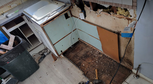

Doohicksie Posted March 28, 2023 Author Report Posted March 28, 2023 I kind of knew that going into this project, but the amount of time it took me to get the remedial work done was greater than I expected. Since we're putting new backsplash in I knew we had to replace some drywall but once the old cabinets were out I realized we needed to replace significantly more drywall that I planned for. A lot of it is you just have to take the old stuff out and see what's left and what needs to be fixed/updated before you move on. We had the house rewired when we moved in but I wanted to add some plugs on the countertops (the house only had two plugs and the electrician didn't add any more than that), and I also didn't like the way they wired the dishwasher/disposal circuit so I had to re-do that. In the picture below you can see the plug nestled in the wall but kind of hanging out: That's for the dishwasher. The metal clad wiring coming out from the box is for the disposal circuit which was run inside the cabinet (which is why it needed the metal cladding); the circuit goes to a switch and then to a plug that the disposal plugged into. The switch was mounted on the front of the cabinet and we bumped it all the time while using the sink, turning the damned thing on when we didn't want to. Because the drywall is so brittle there the dishwasher plug box was never really mounted properly, so I had to replace that drywall. Also, the outer insulation of the wire didn't quite reach all the way into the box so when I moved to switch up to the wall over the cabinet, I ran the circuit to the switch box and passed two wires out: switched power for the disposal and unswitched power for the dishwasher. 1 Quote

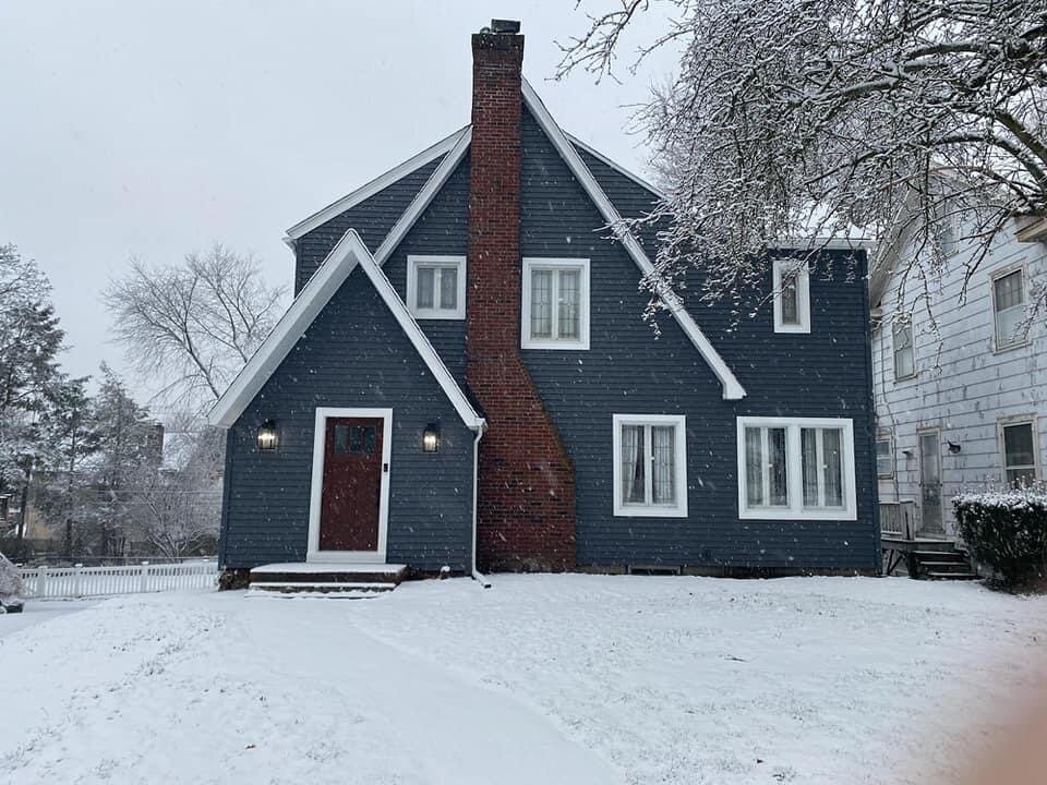

Porous Five Hole Posted March 28, 2023 Report Posted March 28, 2023 3 hours ago, BUFtoNCfan said: I hate jobs like this because nobody is going to say “God I love your new widows and siding!” My neighborhood is very walkable and the project took forever, so people noticed and appreciated the rehab we did. 1 3 Quote
shrader Posted March 28, 2023 Report Posted March 28, 2023 Just now, Porous Five Hole said: My neighborhood is very walkable and the project took forever, so people noticed and appreciated the rehab we did. You could have kept the old door and gone for sabre colors.😁 1 Quote
