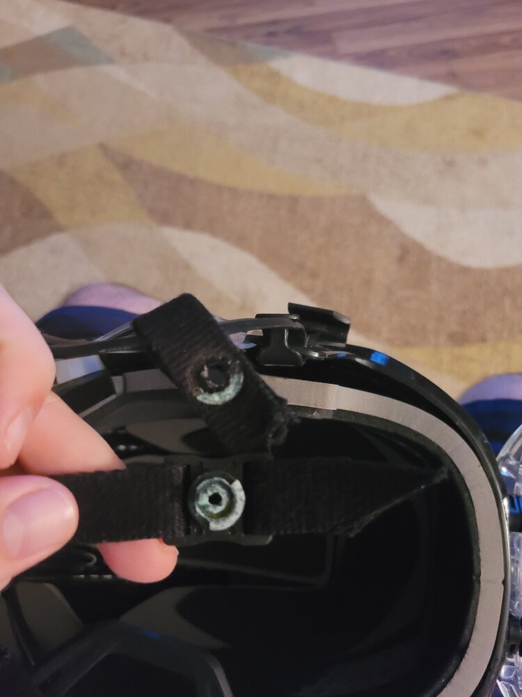

ubkev Posted September 2, 2020 Report Posted September 2, 2020 Guys, is there a parts fix for this someone can link me to? Chin strap is busted. I'll tape it for this week. But I'd like to be able to snap it again. USA Hockey are real ball breakers when it comes to helmet safety. Even when it's a 10¢ head. Quote

French Collection Posted September 2, 2020 Report Posted September 2, 2020 5 hours ago, ubkev said: Guys, is there a parts fix for this someone can link me to? Chin strap is busted. I'll tape it for this week. But I'd like to be able to snap it again. USA Hockey are real ball breakers when it comes to helmet safety. Even when it's a 10¢ head. The parts are very cheap but you would need to drill out the old hardware with a small bit and have a setting tool for the new snap. A hammer and a punch could set the hardware in a pinch too. Sporting goods store may have the parts. I didn’t think of a tailor but someone who does leatherwork could do the same. Quote
Taro T Posted September 2, 2020 Report Posted September 2, 2020 7 hours ago, French Collection said: The parts are very cheap but you would need to drill out the old hardware with a small bit and have a setting tool for the new snap. A hammer and a punch could set the hardware in a pinch too. Sporting goods store may have the parts. I didn’t think of a tailor but someone who does leatherwork could do the same. Or, scavenge the parts off an old helmet & he's back in action for no particular effort & nothing out of pocket. Old youth hockey coach trick: when scrapping old equipment save ALL the snaps, screws, & eyelets you can. Keep 'em in a freezer quality Zip lock baggie & they won't scatter out of your bag. You WILL need them at some point. 1 Quote
French Collection Posted September 2, 2020 Report Posted September 2, 2020 1 hour ago, Taro T said: Or, scavenge the parts off an old helmet & he's back in action for no particular effort & nothing out of pocket. Old youth hockey coach trick: when scrapping old equipment save ALL the snaps, screws, & eyelets you can. Keep 'em in a freezer quality Zip lock baggie & they won't scatter out of your bag. You WILL need them at some point. Zip lock also keeps hardware from rusting in my sweaty gear bag. 1 Quote
Taro T Posted September 2, 2020 Report Posted September 2, 2020 Just now, French Collection said: Zip lock also keeps hardware from rusting in my sweaty gear bag. There is that as well. There was a reason that "freezer quality Zip lock" was specifically referenced. Those bags will stay shut, sealed, & non-torn longer than even their regular bags and significantly longer than the bargain sealable bags. A hockey bag can be a brutal environment. 1 Quote
